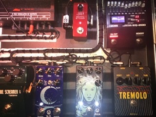

Re: Rack on its way
With massive thanks to marlboro05, my rig is working after installing the GCX.
All I need now, is the ampete amp & loop switch, and I hopefully will be done.
Rig so far.
Currently I run between 2 heads, although the 3rd is on the way. Just need a really good switcher that will switch amp, so I can use 1 fx rack, and a couple cabinets.
Still have the option to add a few more pedals to the fx tray if needed
Rig so far.
