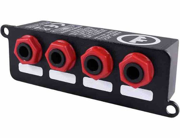

Is there any kind of, for the lack of a better term, Jack Plate that could mount to my board? What I mean is like female 1/4 in
that could reflect the i/o to and from the amps/loops & "pre" switcher FX? Like I would dig being able to just plug * in without lifting or digging around under the board. Am I trippin?

Something like this?
Re: I'm a dummy
We are working to make an interface that mounts using the holes at the side edges of the Dingbat boards... sorry it is taking so long to produce a simple box with some jacks in it :oops:
Your linked box would certainly work, but you would need to mount it using Dual Lock or something similar since there are no holes that line up with its mounting tabs.
