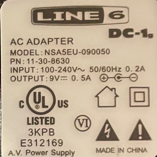

1. I'm using two Line 6 receivers, a G50 which is powered with no issue and a G70, which will not power up completely (just one lamp will illuminate, it doesn't power up all the way) Is there a solution for this?
G70 Power Supply image

To power the G-70 use a Current Doubler Adapter, part# PPAP in Pedal Power 2 Plus outputs 4 and 5 (or 6 and 7), DIP switches set normal and one of the all black (standard polarity) cables supplied.
