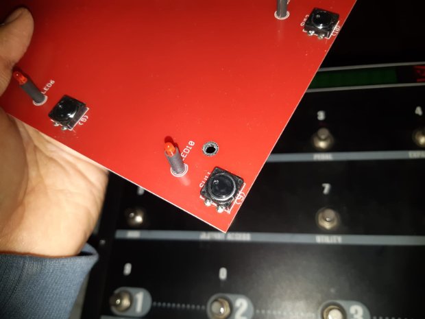

The buttons number 5 and edit do not work in my ground control pro, I attach photos. Please could you help me.
Greetings

Since you have it apart, have you used a multimeter to see if the switches actually switch?
I know you can get these switches from electronic distributors, so if you are good with a soldering Iron you can do it yourself or get someone to do it.

Thanks for the answer, when I press hard the switch sometimes it changes, clearly it is a problem with the switch, where I am it is not easy to get that type of spare part. Thanks.

I’d see if you can find the closest distributor or seller and see if they can get it repaired for you. There was a recall or something with certain boards that had problems with the switches, you could get onto Voodoo and see if it is one of the ones that had the switches changed or buy a new board with the switches on it.
You could do either of them or get new switches from a seller online.
