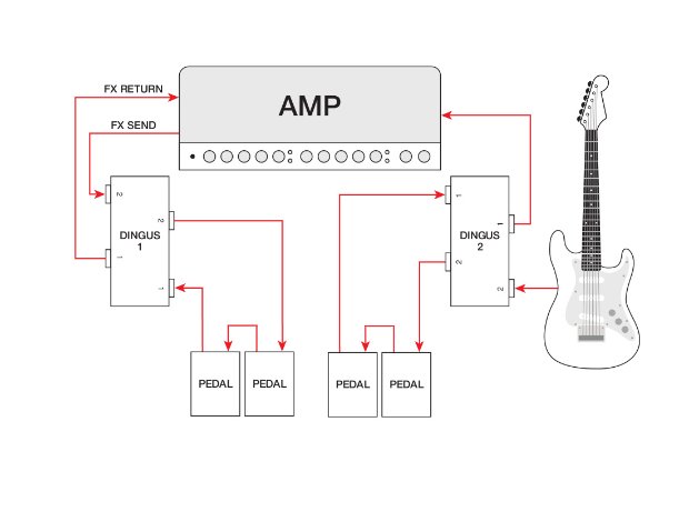

Hello, folks! This is my first post here so my apologies if this has been covered but I did a search here and else where but cannot find any info regarding the setup of two Dingus modules for my Dingbat Medium (with Pedal Power X2). I just ordered these from Sweetwater this morning so they have not arrived yet but I just wanted to get an idea of how to properly set everything up when they do arrive. The list and chain of my pedals is this:
Gtr. > PolyTune3 > Morley Mini wah > Ibanez Tube Screamer Mini > ISP Decimator Mini > front of amp
Amp FX Send > Dunlop Volume pedal > tc electronic corona mini > tc electronic spark boost > tc electronic vortex mini > tc electronic flashback mini > Amp FX return
I saw the diagram on the product information page but I do not have a PX-8 switcher on my Dingbat. Can someone help me out? Thanks in advance!

I doctored a diagram to show a basic setup using two Dingus (Dingi?) with some effects in front of the amp and some effects in the FX Loop of the amp.
The pedals connected to "Dingus 2" will be routed to the front of the amp.
The pedals connected to "Dingus 1" will be routed to the amp's FX Loop.
(I only drew it with two pedals in each group, but feel free to chain as effects many as you would like into each group)
